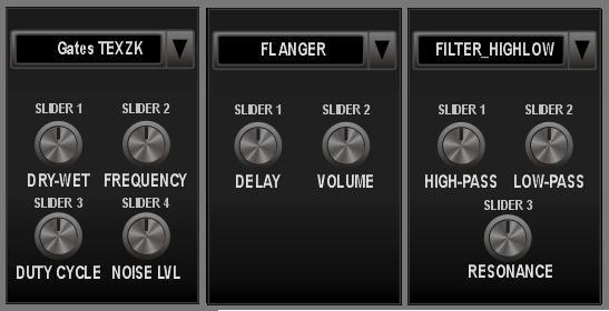

Gia ta skins yparxei lysi.. Katw apo to koutaki pou sou deixnei as poume to epilegmeno effect ftiaxneis ena mikro pannelaki.
Auto tha allazei kathe fora pou epilegeis ena effect. Etsi mporeis ekei na deixneis oxi mono ta energa sliders (oxi dld ta fakes) alla kai me opoia seira se voleuei, akoma vevaia kai na deixneis ti akrivws kanei to kathena (titlous)
Auto gia na ginei ..(ligo skinning twra) apla sto visible kathe tetoiou pannel pou tha ftiakseis grafeis..
<pannel ....... visible="effect select 'Flanger'"

Opws vevaia katalavenete tha prepei i na ftikaseis tosa pannelakia osa ta Fx pou yparxoun ... lol i apla na voleuteis esy o idios me ta Fx pou xrisimopoieis.

Pros to paron omws ginetai mono auto pou lew. Mi se fovizoun ta pannelakia sou eipa tha allazoun automata. Oson afora gia tis idiaiterotites tou kathe xristi, pisteuw oti me 10 vasika effects exeis piasei to 70% tis pelatias. Alla na sou pw kai kati, who cares, esy kaneis tin douleia sou..
Pare mi aidea apo ta pannelakia pou tha valw sto TCmania

To dokimasa kai douleuei, teleia !
Phantom , ftiaxneis ta pannelakia opws se voleuoun kai sto visible vazeis...
visible="deck 1 effect select 'flanger klp'"
