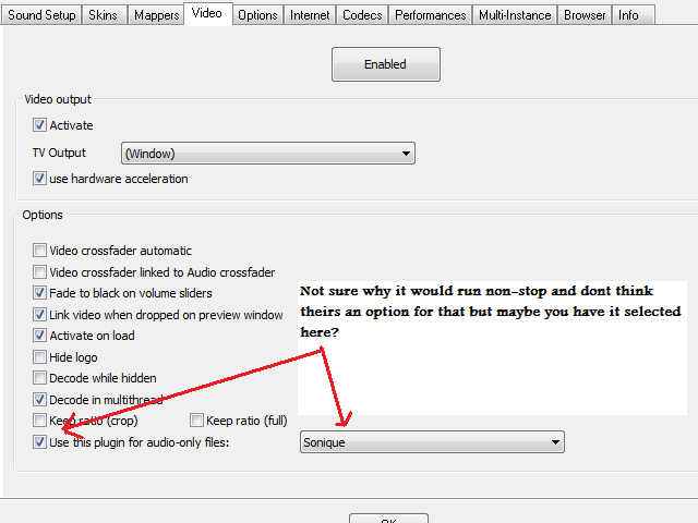

Hi! a while back i did some research on sonique and found the visual pack (Sonique v.2) now in them the Cel's 72 pack were included and some from the 84 WHICH are not recomended.they wont work and cause problems.the 72 pack is the way to go and you can go to my blog section and get the link for a few more (@ 10) including some slightly modified plugins (x2) that run in the sonique engine.concerning your problem..humm..not sure. did you check in configurations that sonique is not selected to run continuaslly? also folder and file placement is important. you can have SubFolders you know ( this are needed for the other plugins that can run inside the sonique folder)...instructions are in my Blog.Good Luck...

That is exactly what it was, when those two are on at the same time I am unable to toggle the soniuqe effect on and off. When the plugin box is unticked I can toggle it on and off. Also when I was getting the crash I did not have a external video source running. I was just using the extra pop up video screen in VDJ. I connected my TV to the laptop today and tried to make it crash again but I could not do it. So that's good news.

Thats what I meant also...you had it selected under configurations ....glad you got it sorted..
