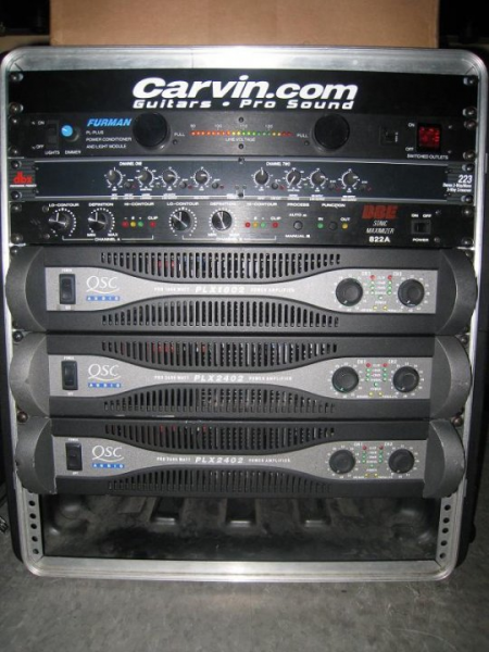

Here is My Setup. I have amp 1 for the speakers & Amp 2 for the subwoofers. ( Amp 1 is now a QSC Plx 2402 & Amp 2 is now a QSC Plx 3002) I am using a DBX crossover. If your amp has an adjustable fliter, then you dont need a Crossover.
