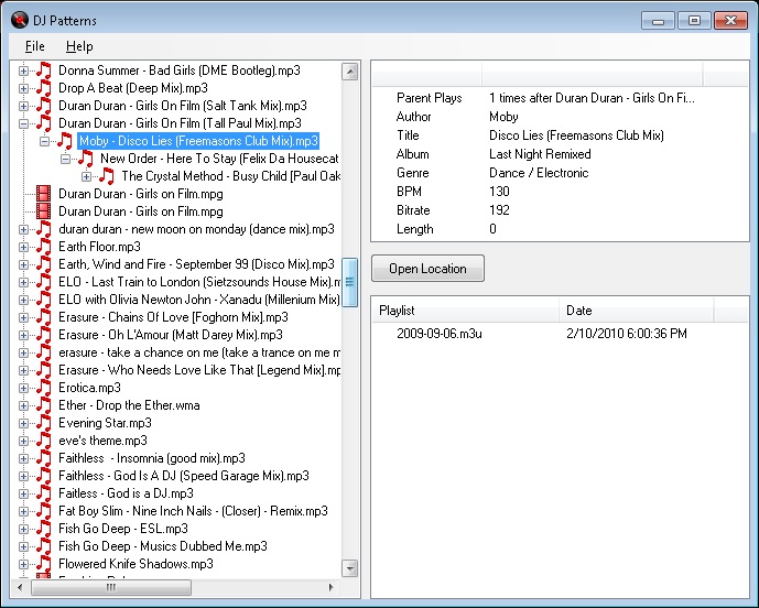

The FILE menu has two choices: \"Add Folder\" & \"Add Playlist(s)\". The Add Folder allows you to select a folder (obviously) and it will look for all playlists in that folder. The Add Playlist(s) allows you to select one or more playlists. You can also drag-n-drop a folder or playlists to the tree to add them.

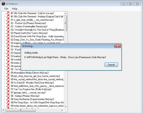

Once you add playlists it scans them (see image below) and adds them to the list. So, for example, you can choose the VDJ "Tracklist" folder, and when that completes you can add another folder or other playlists.
The scan process is threaded so that you can cancel part way through the process. For example: I have 40 playlists and it takes a few minutes to scan through all of the them and add the songs into the tree. If this process is taking too long you can hit "cancel" and stop the process.
There is also a search function so that you don't have to scroll to find the song. (Found via the FILE menu, or CTRL+S)
This is the first iteration of this application so if there are other ideas I'm open to them, and at very least I hope this helps you do your jobs a little better.
