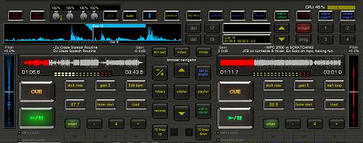

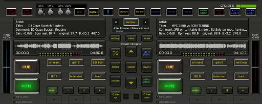

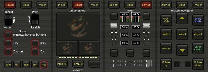

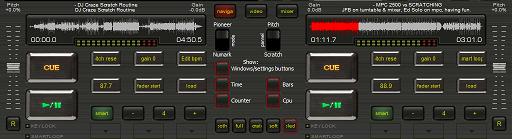

Hi all,
Nearly finished this update. See the pictures (low quality) and let me know what you think.
Special design for touchscreen with a res. of 1024x768pxl.
with rhythm
or cues
or sampler
scratchwave or pitchsliders
4 different center pannel
Best regards,
John
with rhythm
or cues
or sampler
Best regards,
John

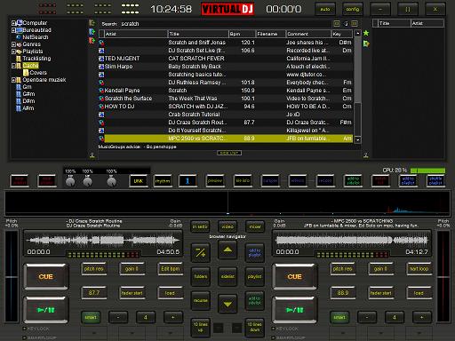

WOW how do u have enough room on 1024X768, have you thought about 1280X1024?? Just wonderin, looks awesome!!
Posted Mon 18 Jan 10 @ 8:52 pm
Thanks discobrian24,
Ow yes, room enough for this one. All other sizes can be done with the resize-tool.
The 4 pictures from the top are 50% scale, the last one is real-size.
I found a little issue with this skin. If you open this one for the first time the center-pannel is empty (I think).
To solve this u can create a shortcut for one of the pannels. --- skin_pannel 'rhythm_view' ---.
This will show the rhythm window and the "toggle pannel button".
I will create a button in the settings pannel.
Posted Tue 19 Jan 10 @ 12:51 am

OK Looks GREAT but I am havin a few issues:
1. I cant see any song names while loaded into decks??just the time.
2. I want to change the way that when you click on a vid preview it starts the deck, I want to turn that off.
3. I want to change the play/pause button to actually pause not start from the beginning. (EDIT Changed Play_Button to Play_Pause, that works)
Please if you are on respond what i need to do.
Posted Fri 22 Jan 10 @ 7:47 pm

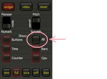

Hi discobrian24,
about your questions
When you have selected the rhythm-pannel or the cues-pannel you can read the artistname - title - comment above the songposition(and time)window. If you select display-pannel you see the whole track info.
I changed the action for the video-screens. It's simple to use when you play karaoke. Just load the next song, cue it up and when the time is right you click on this window. A sort of auto mix. I'll try to create a switch for this (auto mode or normal mode)
You mean the pioneer or numark function. You can change this in the skin settings-pannel.(look at the first picture of the bottom row in this topic)
Pioneer = play/pause
numark = play/stutter
Best regards,
John
Best regards,
John
Posted Fri 22 Jan 10 @ 10:51 pm
Update coming soon with your request.
I changed the font because not all characters where showing right.
Changed the deck 1 & 2 -video- windows, a copy of from the original v.6 skin. My button is replaced to the multi-button "1 <- 2" and "1 -> 2"
I am sure that I forgot to mention something here. But you'll see...
ps:Thanks vdj team for moving the old skin.
again, Best regards,
John
John
Posted Sat 23 Jan 10 @ 1:02 am

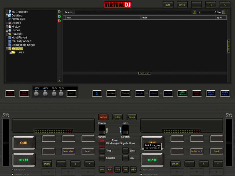

ok here is the issue there is no box next to the preview channel (active deck control)
Posted Sat 23 Jan 10 @ 3:55 am
Also I couldnt find the newest on the download page! By the way once I get these lil issues I am havin fixed THIS WILL BE MY SKIN of choice!!!
Posted Sat 23 Jan 10 @ 3:57 am
there is a skin settings button that shows this pannel (below). then hit this button (see arrow).
a big "thank you" for that..
Best regards,
John
Best regards,
John
Posted Sun 24 Jan 10 @ 12:40 am
That button is not in my skin???
Posted Sun 24 Jan 10 @ 12:43 am

ADD: Drag and drop songs into decks
And ADD a way to turn off the auto mix when pressing vid transition (I know you saw this but just writin it all together)
Posted Sun 24 Jan 10 @ 12:49 am
OK. this is an update issue. i've allready fixed this. For now you can create a shortcut with the mapper.
Type this action in the mapper.--- skin_pannel "deck_display" ---.
This is only for this time. next time you start vdj it will be ok..
Posted Sun 24 Jan 10 @ 12:50 am

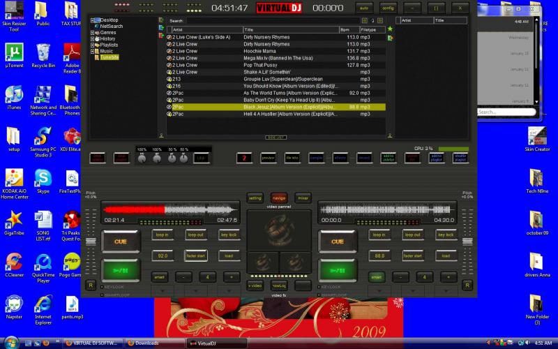

Ok cant do anything here for now, but will look when I get home. Also what do I have to remove in the xml to stop that auto play, I can wait til you update if ud like:) Gotta run will check in later,
Posted Sun 24 Jan 10 @ 1:05 am
I think they're working on the update now, because it's not in the download list now.
you cut the first line.
- - - <button pannel="video" action="deck 1 video_transition & deck 1 auto_crossfade 6000ms & deck 1 play"> - - -
<pos x="433" y="651"/>
<size width="78" height="51"/>
</button>
then paste this line
for deck 1 use this:
- <button pannel="video" action="deck 1 video_transition" dblclick="video_crossfader 0%" rightclick="video_crossfader 0% while_pressed"> -
for deck 2 use this:
- <button pannel="video" action="deck 2 video_transition" dblclick="video_crossfader 100%" rightclick="video_crossfader 100% while_pressed"> -
</button>
Posted Sun 24 Jan 10 @ 1:16 am
