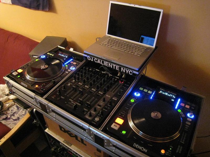

Denon players will do exactly what a timecode CD does, but over much more reliable HID interface.. plug and play with VirtualDJ.
(controls VirtualDJ without having to put a timecode CD in...)
The 3700s players features a high motorized torque rotating platter on top, with even a vinyl there, giving a real vinyl feel
In addition it plays regular CDs', external drives etc
Atlernatively the Numark NS7
Also plug n play with VirtualDJ (but does not play real cds..)
Has motorized torque and feel of vinyls
I have the denon 3700s and the platter feels great. I was able to figure out how to make the platter very smooth with no drag.

That Denon Setup looks nice Ill have to demo them myself before I commit to buy.
