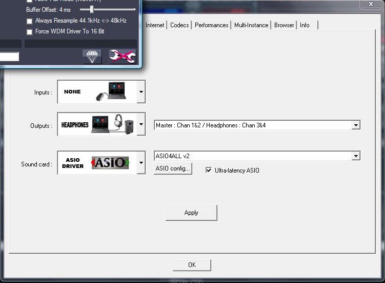

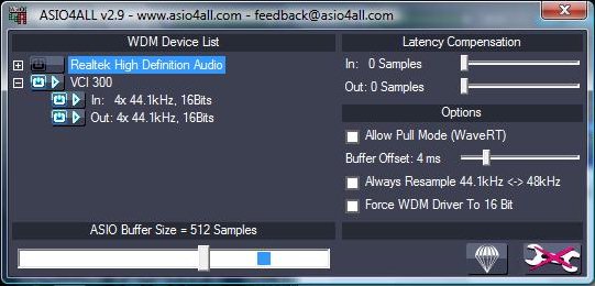

Try these settings for the VCI-300.
.jpg)
.jpg)
Posted Tue 10 Nov 09 @ 12:20 pm

Damn, rushed home to try the suggested audio setup and didn't work says Error: Driver Error-Not Enough Drivers
Posted Tue 10 Nov 09 @ 7:48 pm
means your current soundcard setting in VDJ is not logic ;)
Just make a logic soundcard setting, and all is fine :)
Posted Tue 10 Nov 09 @ 7:55 pm

Got to work yesterday without logic. In ASIO4ALL I think it was trying to push sound for Lappy sound and VCI/Headphones. Just clicked clicked on VCI in ASIO and works.
DJ Norway, just in case I hook up to speakers and sounds like crap though, what is this logic that I have to setup and where?
