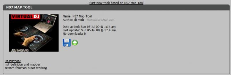

I have just upload the map of the ns7 on vdj tools with using your link !
thanks

I just add new element in the map :
load file on deck 1 & 2
control of the song on platter to make it slower or faster , and in pause mode you can know positionning your song for cue point !
fader reverse fixed
and i'm working on fader start it works but not correctly :
<map value="FADER_START_A" action="fader_start" />
<map value="FADER_START_B" action="fader_start" />
if someone has ideas ...
The update map is avalaible on vdj dowloads tools : Ns7 def and map v1.2
thanks
