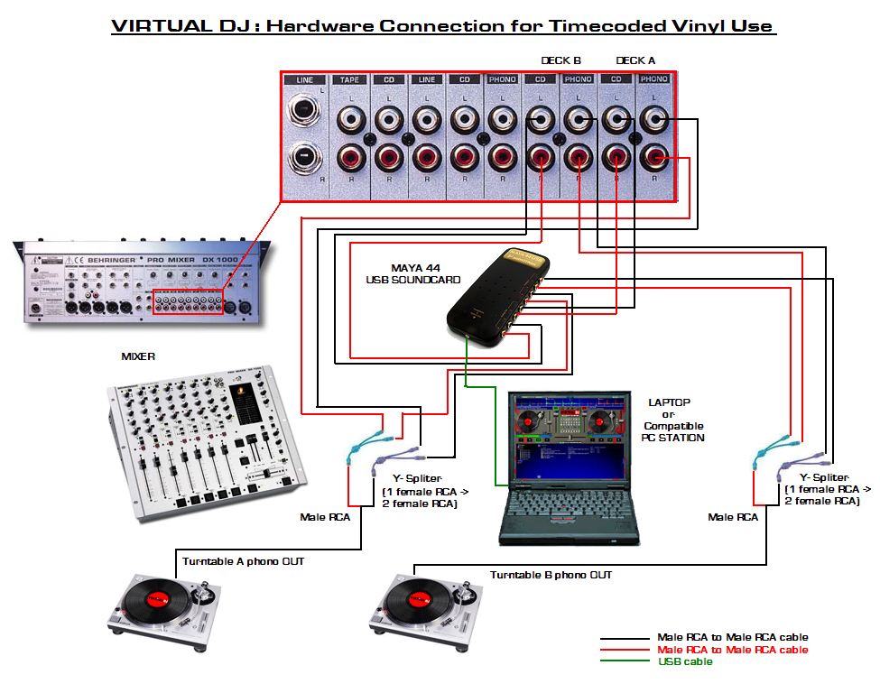

follow this picture
http://www.virtualdj.com/image/oldblog/3/1/image.jpg
