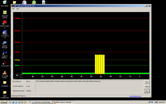

here is a pick of the older slower dual core with everything on virus, firewall, network etc. with 26 total processes running on XP
Posted Wed 04 Feb 09 @ 10:01 am
sorry didnt post for some reason. here is the Compaq 1.9 dual with xp and 26 processes etc.

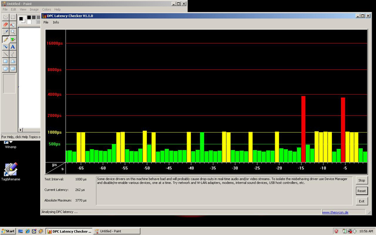

and this one is my gig laptop HP 2.1 dual hp loaded with vista and 24 processes running no internet, network etc.
i do not get any audio pops, clicks or issues but seeing the reports from dpc checker i am suprised that i don't. i have checked all my devices and all are "working properly" once and a while on the hp machine i see a huge spike to the top with red. any more help would be great. i like to have my machines runnign the best they can.
