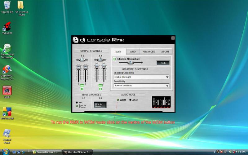

Just had a thought, open the RMX control panel and tell me what you see, or post a screen shot (would be better)
Does it look like this
i.e. slider in the same position.
Posted Thu 08 Jan 09 @ 6:58 pm
Yea it looks exactly like tat and yea I did do the config.
Posted Thu 08 Jan 09 @ 8:55 pm
