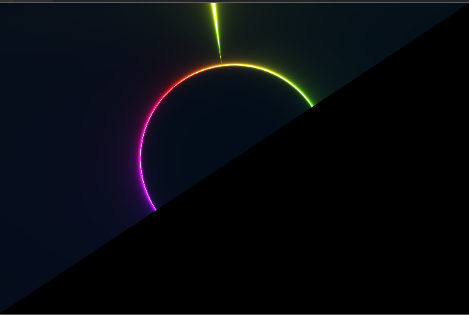

Posted Thu 11 Jan 24 @ 2:08 am
Well, I'm closer, getting half of the screen black diagonally.
Posted Thu 11 Jan 24 @ 2:24 am
Any recommendations on debugging what could be preventing the texture from passing through and the diagonal black split on the screen? I'm guessing it has to do with the vertices not being correct, but I've copied bit for bit pretty much what you supplied.
Posted Sun 14 Jan 24 @ 10:16 pm
djcelPRO InfinityModeratorMember since 2004
I think it's indeed vertices too.
Drawing is based on 2 triangles ("D3D11_PRIMITIVE_TOPOLOGY_TRIANGLELIST") and the index of the vertices is important. (Clockwise or counterclockwise)
Can you post a screenshot so we can see it?
Posted Mon 15 Jan 24 @ 4:54 pm
Posted Mon 15 Jan 24 @ 8:42 pm
Adion's code should be ok but here is another way to write the vertices
struct D3DPOSITION
float x;
float y;
float z;
struct D3DTEXCOORD
float tu;
float tv;
struct D3DXCOLOR
public:
D3DXCOLOR() = default;
D3DXCOLOR(FLOAT r, FLOAT g, FLOAT b, FLOAT a)
this->r = r;
this->g = g;
this->b = b;
this->a = a;
operator FLOAT* ()
return &r;
FLOAT r, g, b, a;
struct TLVERTEX
D3DPOSITION position;
D3DXCOLOR color;
D3DTEXCOORD textcoord;
TLVERTEX pNewVertices[6];
void CMyPlugin::UpdateVertices_D3D11()
pos_x = Xo * width; // 0
pos_y = Yo * height; // 0
pos_width =(Xmax - Xo) * width; // width
pos_height = (Ymax - Yo) * height; // height
D3DPOSITION P1 = { pos_x , pos_y , 0.0f }, // Top Left
P2 = { pos_x , pos_height + pos_y * 2 , 0.0f }, // Bottom Left
P3 = { pos_width + pos_x * 2 , pos_y , 0.0f }, // Top Right
P4 = { pos_width + pos_x * 2 , pos_height + pos_y * 2 , 0.0f }; // Bottom Right
D3DXCOLOR color_vertex = D3DXCOLOR(1.0f, 1.0f, 1.0f, alpha);
D3DTEXCOORD T1 = { 0.0f , 0.0f }, T2 = { 0.0f , 1.0f }, T3 = { 1.0f , 0.0f }, T4 = { 1.0f , 1.0f };
// Triangle n°1 (Bottom Right)
pNewVertices[0] = { P3 , color_vertex , T3 };
pNewVertices[1] = { P4 , color_vertex , T4 };
pNewVertices[2] = { P2 , color_vertex , T2 };
// Triangle n°2 (Top Left)
pNewVertices[3] = { P2 , color_vertex , T2 };
pNewVertices[4] = { P1 , color_vertex , T1 };
pNewVertices[5] = { P3 , color_vertex , T3 };
Posted Sun 21 Jan 24 @ 8:02 pm
