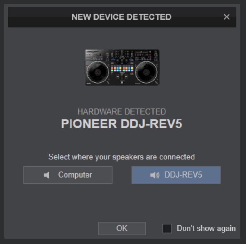

Hello,
each time i plug my laptop to the controller, the sound comes out from the laptop speakers. I have to close VDJ and reopen it, and then the sounds comes out from the controllers output.
How to set it up so that the sound comes out from the controller straight away ?

VirtualDJ doesnt force any Audio setup when a controller is connected.
But if you get the "New Device Device detected" window https://www.virtualdj.com/manuals/hardware/pioneer/ddjrev5/setup.html then you can easily select it (or from the AUDIO tab of Settings)

So you mean that each time i connect my controller, i have to select the controller as a new device, and restart VDJ ? Because that's why i have to do. I ticked the "don't show again" checkbox so that the windows does not pop up everytime i connect my controller, but it does not prevent to have to restart VDJ

My main issue is not having to select the controlers output when the pop up shows, that's annoying but that's just a click. My main issue is having to restart VDJ. I mean i usually connect my controller first. If i'm requested to select the controller as output, i select it, I pick a song and i hit play and the sound ALWAYS comes out from the laptop speakers. I have to close/restart VDJ, and then i hear the sound from the big speakers (controller output).
I usually prepare my set earlier before connecting the controller, so if VDJ use the last sound interface used, why am i never requested to select the laptop speakers when i use VDJ with no controller connected ?

WHERE do you do that ?
On the "new device detected pop up window". BTW i don't understand why VDJ detects à "new" device each time i connect de controller.
On sound setup window ?
No
Do you hit Apply afterwards ?
i hit the "ok" button.

So, in order to understand:
You use DDJ-REV5 on MAC OS.
When the detection window appears on screen, you click on DDJ-REV5 button and then the Ok button (so, these are 2 clicks)
And then the sound doesn't come from REV5 but from your MAC ?
And you have to restart VirtualDJ ?
Right ?
Right ?
Posted Fri 01 May 26 @ 10:36 am

Exactly
