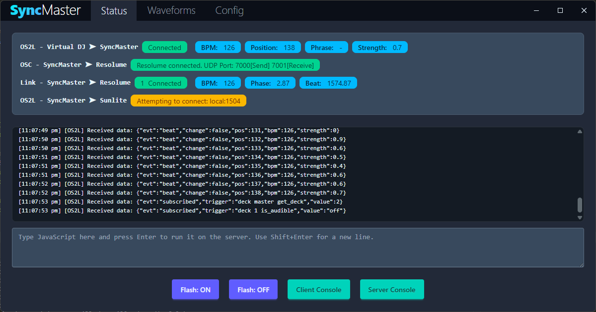

If you think that's unelegant wait till you hear this.... 😂
I sync Virtual DJ to lighting (Sunlite) and visuals (Resolume). For Resolume I started off using Ableton link and sending data via midi, but mapping each midi note to different options in Resolume was tedious and if you change your Resolume layout sometimes they move and break. And if you accidentally loose one there's no changelog, you just spend hours debugging.
I decided I wanted advanced control, so I wrote my own OS2L software, it sits between Virtual DJ, Resolume and Sunlite. This allows me to control Resolume via OSC giving me much better control. It started really simple but now it includes a full sequencer, which manages effects, bumps, phrases, color palettes etc. It actually reads POI data directly from the database.xml and allows me to do some really advanced things that just aren't possible or way to tedious without it.
It was originally a command line app written in Node.js but now it has an Electron interface, with multiple tabs to make debugging, configuration and management easier:
