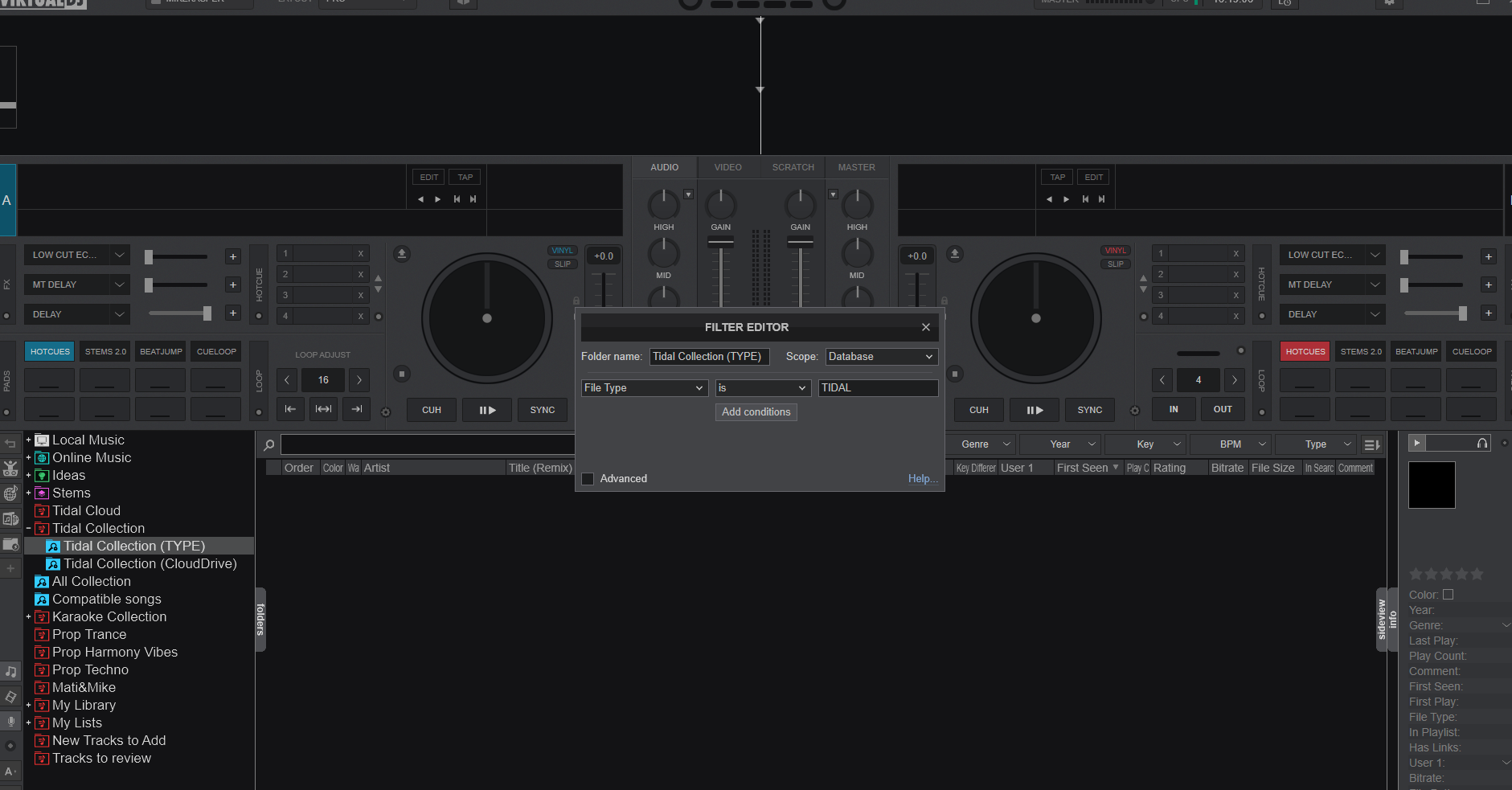

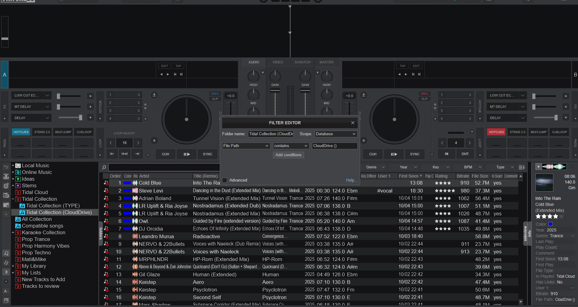

Continuing the topic — after following your instructions, the synchronization started working (Thanks!), but I noticed another issue. The FilePath field, which I used to filter Tidal files, changed from FilePath=Tidal to FilePath=Clouddrive(), which means I also need to update the filtering for Tidal files.
As a side note, the FileType field was cleared (it previously contained the record TIDAL), but filtering by this field didn’t work before anyway.

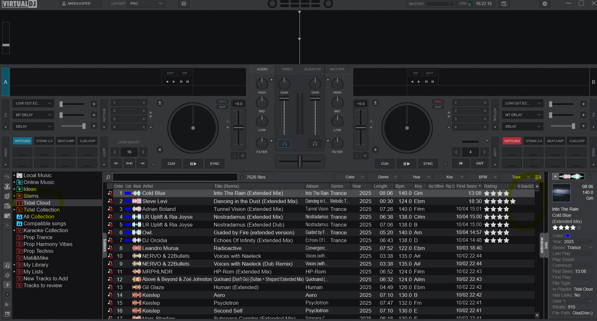

Another issue is that after closing VirtualDJ, the entire Tidal Cloud folder (which syncs with the cloud) disappears from in_searchdb when the program is restarted, and I have to add it again manually.

For filters, you can use Online=1, or Provider is Tidal I think?

Thanks for the filtering tips — both methods work!
However, 'in_searchdb' doesn’t work on either PC. I get the same result after closing and restarting VDJ. (even with the clean db) Maybe it’s some kind of bug...
