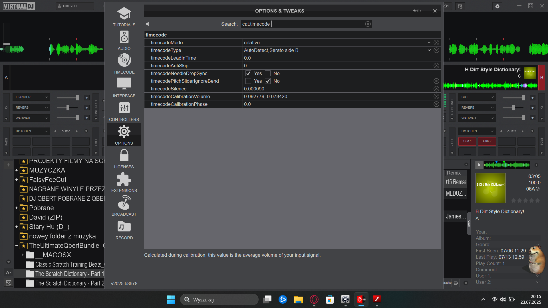

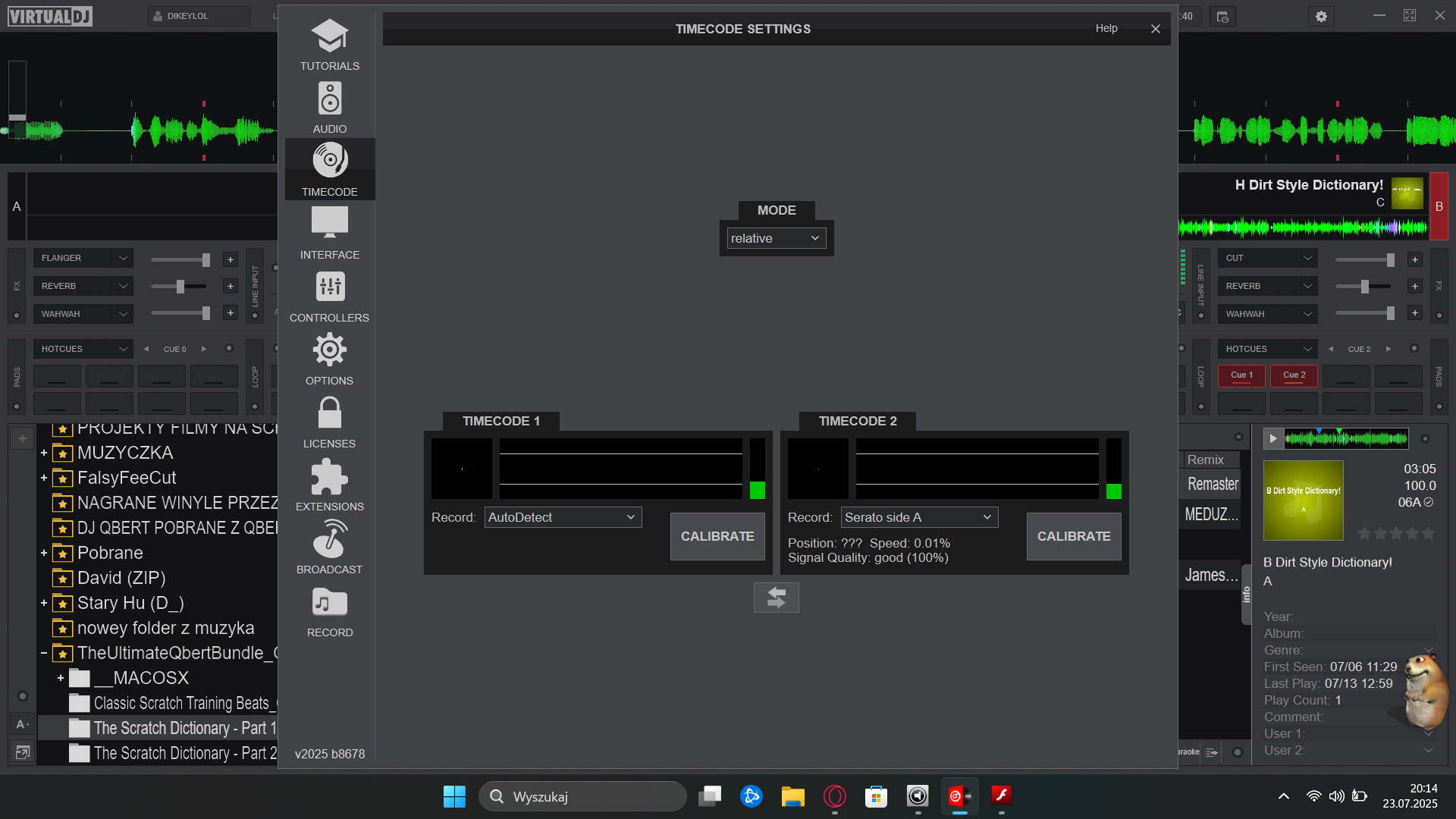

i think this is relative mod
Posted Wed 23 Jul 25 @ 6:15 pm
Yes.
Also, your timecode settings are different from default, and some of the choices made would make things even more sensitive
It's probably recommended to return those to their defaults, and probably only reduce the timecodeSilence lower than the default if you find you slow scratches aren't accurate (I've only ever lowered it to 0.01 just to try it, the default works fine for me) or if using Phase in DVS mode (Phase does the rumble noise reduction to give a clean signal to the DVS engine).
- timecodeAntiSkip = 0 is applicable to smart mode (by default I think it's set to 3), and that makes that mode even more sensitive to skips.
- timecodeSilence is very low (by default it's set to 0.1 but your setting is so small it might effectively be zero), which would make the system more sensitive to rumble noise corrupting the manipulation
