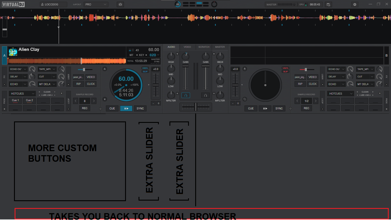

but I've worked with head mouse users before, I don't know the size of buttons that would work best for you, but I could do something like this to swap the browser to a performance panel [which can be swapped back for track selection]
could you work with 16 or 20 custom buttons, and a couple of extra bar sliders? you tell me the size of stuff you can comfortably work with and I can get it made.

Thank-you so much. I've just chosen to use FX +3 & the 4 customised buttons consisting of Reverb, Flanger, Cut & Filter. I didn't want too many buttons apart from one more which is 'Phaser' before it gets too complicated. Could you make that one more button for me? Could it be located where the 4 customised buttons are?
