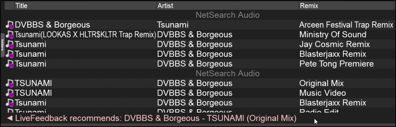

Just a few seconds after a track starts playing on a live playing deck, Live Feedback will recommend a track and it’s information will be displayed on the bottom of the File List. The recommendation is based on what other DJs have played most of the times, right after the playing track.
LiveFeedback will provide a recommendation in the bottom of the File List section in pink. Clicking on the arrows on either side of the recommendation will cycle through other common selections. Clicking on the recommended track will populate the file list with search results from your local database, Online Music and/or NetSearch.
If you wish to turn LiveFeedback off, this can be done in Options and setting liveFeedback to "No".
