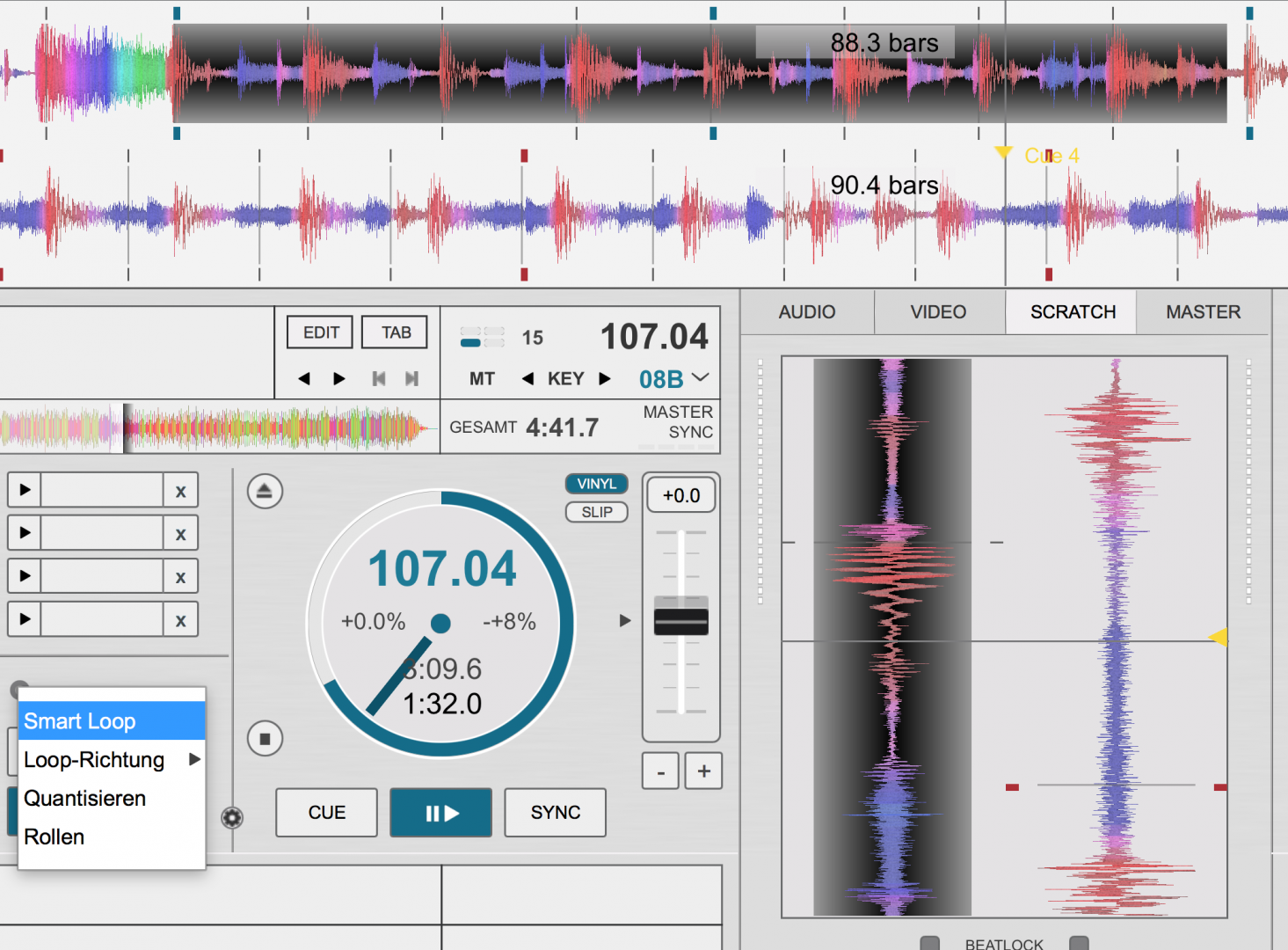

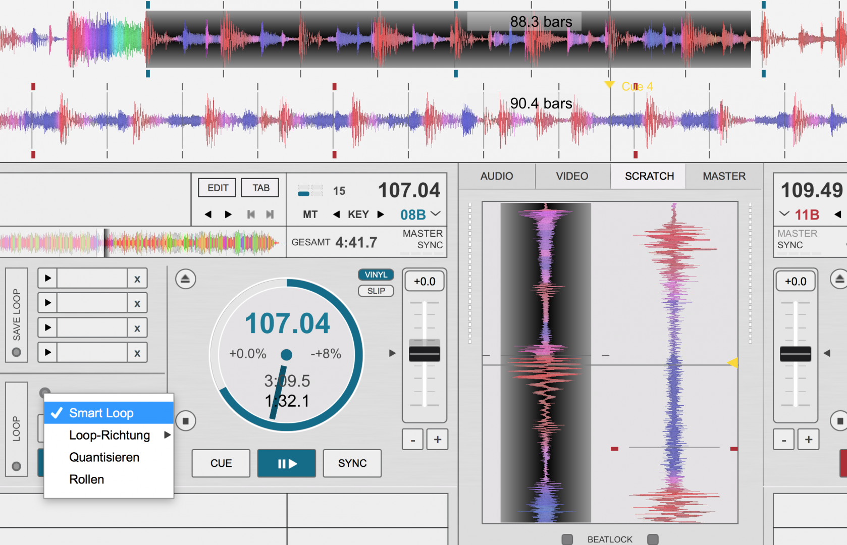

Regarding the loops, if I understand correctly you are trying to set a loop at a point where the between the start and end of the loop there's an extra beat-grid marker set?
Posted Wed 13 Jan 21 @ 6:18 pm
124dsHome userMember since 2019
Hi, not necessary. It is e.g just behind an anchor - means loop stays within the new tempo. Or just before - tempo switch within the loop as you mentioned. But it doesn't matter - in both cases the loop ends before or behind the relevant bar. No matter if smart loop is set.
Thank you, Regards
Posted Wed 13 Jan 21 @ 7:02 pm
