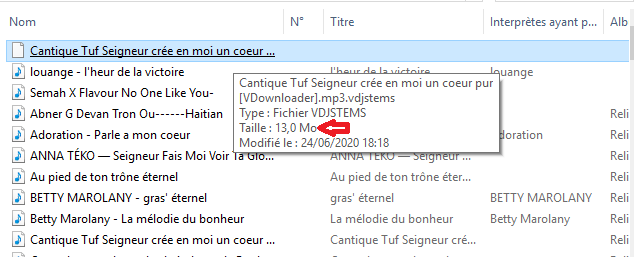

You realize when you right click on a title => precompute stems the number of seconds and minutes it takes to scan the title and create the VDJStems file.
In addition the vdjstems file is 4 times the size of the mp3 file
It's really heavy, you will have to buy a big hard drive.
personally I don't need to scan titles to create vdjstems files
.png)
.png)
Posted Wed 24 Jun 20 @ 11:19 pm
