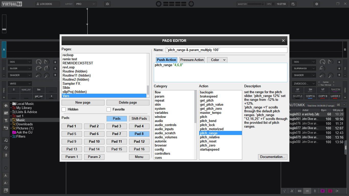

You're talking in riddles and no use so far!
The examples shown in the controller section don't work i've tried under pitch_range adding 4 after it but this just disables the pitch on the controller.
I've tried using some of the examples, they don't work and I have to factory reset it again, bit of a waste of money if it doesn't work and its very frustrating.
Example: https://ibb.co/GFH1ccj
Posted Mon 21 Oct 19 @ 8:54 am

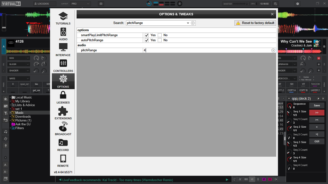

locoDogPRO InfinityModeratorMember since 2013
Posted Mon 21 Oct 19 @ 9:18 am
Thats done it, thankyou.... but for some reason it wouldnt work in the controllers tab
Posted Mon 21 Oct 19 @ 9:28 am
