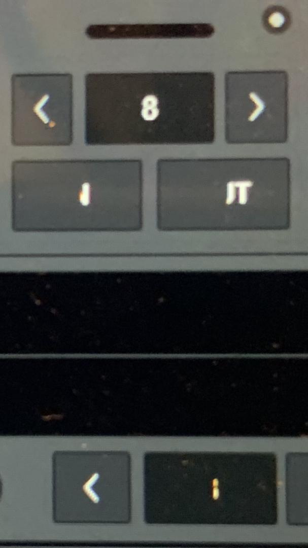

I have noticed lots of little glitches and bugs across the default skin . I am using pro mode.
Sometimes the problem is that sometimes the problem is not. I’ve had flickering in the browser.
And text zone are not appearing correctly on buttons. Restarting VDJ fixes the problem.
Then start using the skin and text zone start going wrong again. and lines appearing in the browser

DJ Format are you using 64-bit when seeing this issue?
Yes I’m using the 64-bit version.

Might be the new crisp clear font render..
Try with cleartype set to "no" in settings, for now..
Done what you suggested . Seems to fix the problem in the skin . So I will leave it on that setting for now.

Also tried to turn off cleartype off and as you say it fixes the issue for the decks but in other areas it doesnt. For instance i was renaming some tracks in the tag editor and parts of the track name were missing.
So looks like its back to 32-bit again, which to be fair has been perfectly good, so will stay with that until the 64-bit issues have been resolved.
