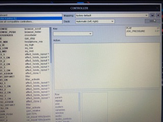

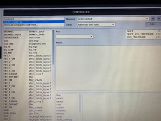

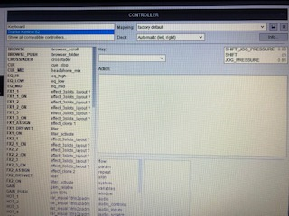

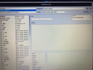

When I press Shift:
Deck B
Deck A
When I press Play:
When I release Play:
Deck B
Deck A
When I press Play:
Posted Mon 09 Sep 19 @ 2:06 am
