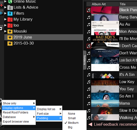

To get the album art of the tracks as in Traktor..
Right-click on any Browser List Header (like Artist, Title etc) then select the Album Art from the offered list.
You can then drag the "Album Art" header and move it at the beginning (as 1st column)
Also from Display Options ->Padding you can adjust the vertical padding so that you get larger height for the Album Art.
As for getting the Album Art like your screenshot (below Folders), instead of toggling the File Info window, you will need to create a custom Browser in your skin, using split panels http://www.virtualdj.com/wiki/Custom%20Browser.html

I'm aware of this artwork slice feature in the list view but that never did it for me even when I was using Traktor which has the exact same feature if you look at the image I attached in my original post above. That sliver is useless and distracting imho and I need to see the full square cover art. I always ended up turning that off when I used to use Traktor. I tried it again with VDJ8 just before I did my post and I just can't use it. The preview pane with full cover art is what I'm after and is a perfect solution for my needs. I do realize that VDJ may shut down any access to tweaking the browser so I'm also considering trying to shoehorn a list preview pane somewhere in the top section if possible. Does anyone know the code to display browser list images? Does that code exist?
@djdad - if you used the coverflow code in a small square space as shown in the rival software, would it just show one cover at a time?
Posted Fri 02 Aug 19 @ 4:24 pm
To answer my own question - no!
Even when in a restricted (square) space, it still tries to display the covers either side.
So now my question is: Is there a way to display the cover art from a browsed song?
[later] answering my own question again........ it's cover source="browser" :-)
Posted Sun 04 Aug 19 @ 1:58 pm
OK, I got it working (to a degree).
Posted Sun 04 Aug 19 @ 3:14 pm
