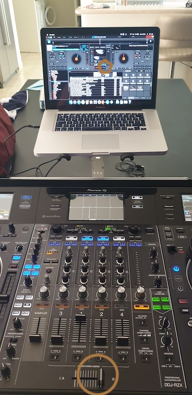

Afternoon all,
DDJ RZX on MacBook Pro
VDJ 8.3
Had this for a while now including on my DDJ SX but I just assumed the crossfader was faulty as it was an old unit (7 years heavy use)
Controller Crossfader only has control from approx 14% to 87%???
Crossfader on the unit is brand new and moves nicely from 0% to 100% left to right and right to left. No issue.
However on the software, VDJ only recognises the movements up to 14% and 87%.... Very frustrating as I am still getting audio and video bleed when mixing... Any ideas on a solution?
Also when crossfader is untouched, VDJ is showing it as tiny movements of up to 5% in either direction.
Any help appreciated.

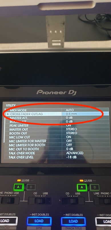

Can you open Rekordbox settings and see if you have applied some extra cut lag
See .. https://forums.pioneerdj.com/hc/user_images/s2537zSDkiAH5zFrrwDc5g.png
EDIT. Actually after reading Pioneer manual, the RZX Utilities is part of unit's firmware and its displayed on unit's screen if u press the [WAKE UP (UTILITY)] button for over 1 second. (so no need to open Rekordbox)
Posted Mon 27 May 19 @ 5:02 pm

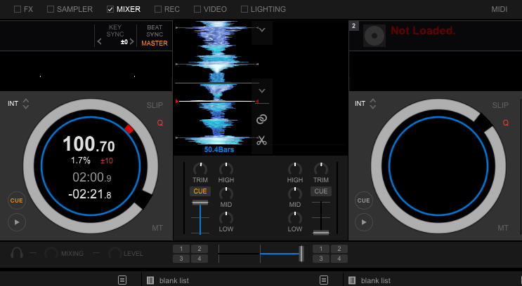

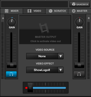

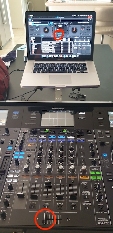

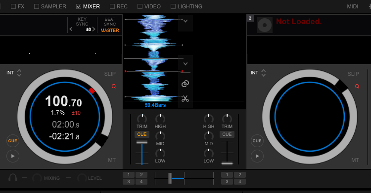

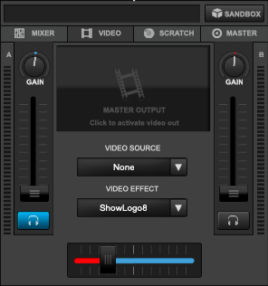

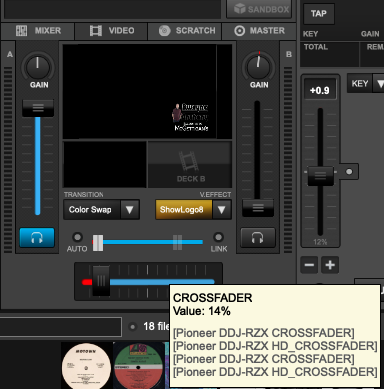

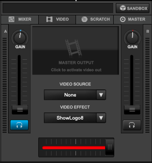

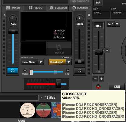

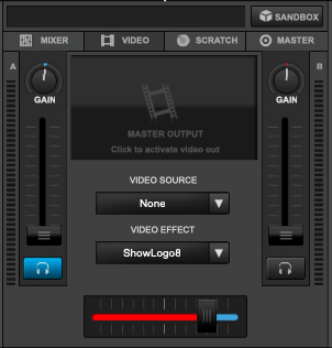

@DJDAD, Sorry for the late response but still no resolve. I've even done a factory reset on VDJ settings thinking I may have clicked a box in error...
Still have HUGE issues with crossfader, everything else appears to be working perfectly but as i VideoDJ, This is essential!
Currently resorted to moving video CF over on the MacBook trackpad! FML! haha
Please see attached images for ongoing issue and clarification and let me know if you require more info?
Crossfader LEFT = 0% No Issue
Crossfader RIGHT = 80% NOT 100% Although CF is 100% on the controller
CF Cutlag is at 0.5mm (doesn't go any lower)
Software still registers both CF and HDCF at 78/79% instead of 100%
HELP!!! haha
Posted Mon 17 Jun 19 @ 1:04 pm

@eazydwayne2000 Can you increase the setting to 1.0 (and 1.5) ,mm and see what values VDJ reports when crossfader is at the edges ?
Posted Mon 17 Jun 19 @ 4:33 pm

Can you describe the tiny movements ? You mean that the crossfader won't stay put to let's say 50% but jumps between 45% and 55% ?

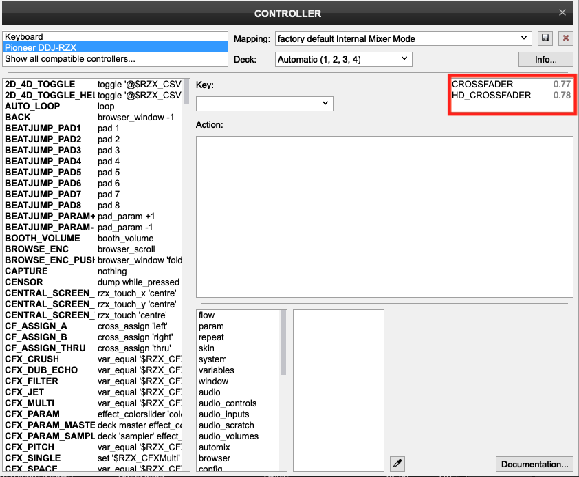

RZX offers both HID and MIDI messages for the crossfader.
HID is much more sensitive than MIDI, but still it should not let the crossfader jump around.
Also from your mappers photo I see that both HID and MIDI protocols report more or less the same value (0.77 & 0.78)
This means that communication with the controller is OK and that there's nothing wrong with the data received by VirtualDJ. (In other words it's the data sent by RZX who have issue)
Steps to find out the cause:
1. Change the cutlag setting as already described. Keep in mind though that what actually this setting does is to "rescale" the crossfader values.
The minimum setting (0.5 mm) is actually the opposite of what you want to fix. It literally means that RZX will send 0 (or 100%) 0.5mm before the physical end of the crossfader (and that's for the internal location) So you should actually increase that setting to 1, or even 1.5 (I don't remember possible values by heart) and try again. If the values you're getting are closer to the ones you should (e.g. you get 5 and 95% with crossfader all the way to the edges) increase it a little more.
However keep in mind that this setting WON'T fix the +/-5% jumps you describe above. Since it rescales the crossover it may make them smaller (e.g. +/-3%) but they will still be present. In that case most likely your crossfader is faulty even if this is a brand new controller and you should have it replaced ASAP (possibly under a DOA warranty)
2. Besides trying to adjust the Cutlag setting, open Rekordbox, update it to latest version and enable on screen mixer. Observe how crossfader behaves with Rekordbox.
If it has the same gaps or if the crossfader on screnn is jumping here & there the same way it does with VirtualDJ then it's 100% a hardware problem of the crossfader itself (and the crossfader needs replacement)
Posted Mon 17 Jun 19 @ 11:02 pm

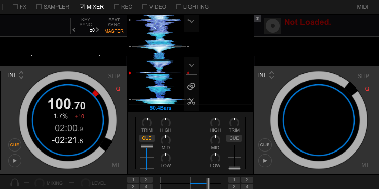

Morning all,
Quick test this morning with Cut-lag variations:
Had to go all the way up to 5.7mm. This gave results of 10% and 100%.
Restarted VDJ and got results of 0% and 87% - so bloody annoying!
With results of 10% - 100%, weirdly, if I raise sampler volume to 100% I get results of 0% to 90% on Crossfader, lower sampler volume to 0% and the readings on crossfader return to 10% - 100%
Vice-versa
With CF results of 0% and 87%, sampler volume at 100% gives results of 9% and 100% on CF! Lower sampler volume to 0% and CF readings revert to 0% and 87%!!!!
Both examples are tested with Cut-lag at 5.7mm (Maximum) tho!
Crossfader in stationary position (eg 50%) gives readings fluctuating from 47% - 51% making very small changes to the values in VDJ literally every 10-20 milliseconds.
I will do a fresh install on a windows based machine tonight and revert back with results!
Beginning to think this MUST be a HARDWARE issue with earthing or shorts somewhere deep inside the controller as there is no direct link to sampler volume and CF found anywhere in the factory mapper!
Banging my head against the wall!
Will test on windows machine later and also review CF behavior in recordbox and let you guys know the results! Thank you for all advice up to now!
Posted Tue 18 Jun 19 @ 4:52 am

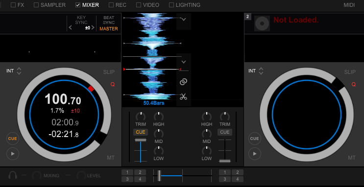

OK, So further testing on Recorbox produces EXACT same results!
Crossfader on controller 100% (i.e fully in right position)
Sampler at 0%
Recordbox
VDJ
Sampler at 100%
Recordbox
VDJ
Crossfader on controller 0% (i.e fully in LEFT position)
Sampler at 0%
Recordbox
VDJ
Sampler at 100%
Recordbox
VDJ
With both softwares behaving in the EXACT same manor, am I right to assume this is a HARDWARE issue (potentially an earth or short somewhere) and I should return to dealer for servicing under warranty?
