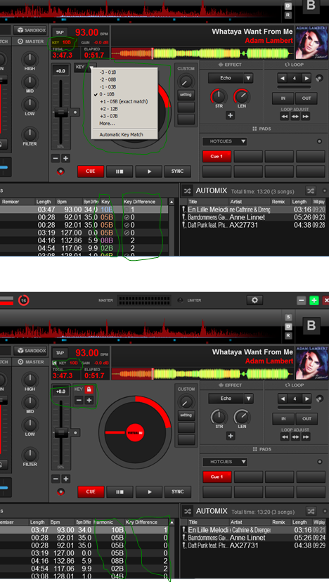

I'm not sure I get the problem
Here are the new version and a previous version with the key functions circled in green.
What is it you are missing in the new version?

djdonnPRO InfinityMember since 2006
My apologies for the alarmist post. Turns out the key column wasn't wide enough on my browser to view the 'check' and the key.
I also created a button to toggle between 'musical' and 'harmonic'.
I suppose i'll get used to there not being separate columns for 'key' and 'harmonic' by using 'key' and 'key difference'.

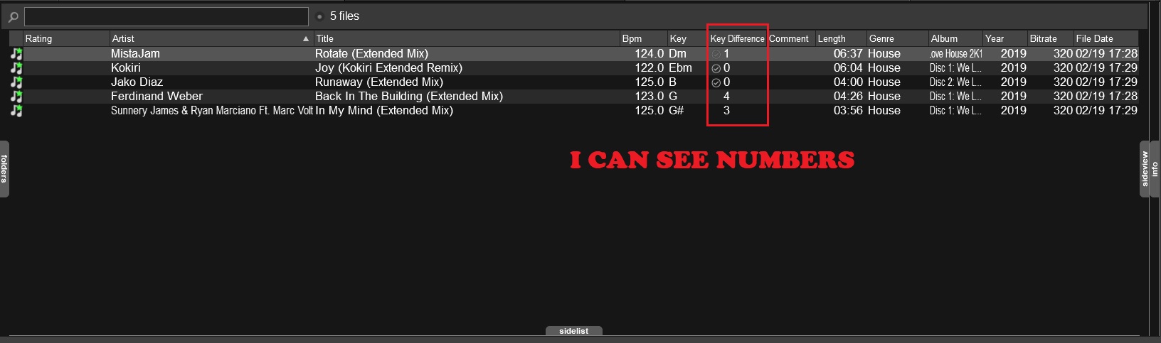

No, the key difference is not in numbers!
Posted Sun 17 Mar 19 @ 6:02 am
AdionPRO InfinityCTOMember since 2006
Maybe the column is a little bit too small? Try to make it a little wider.

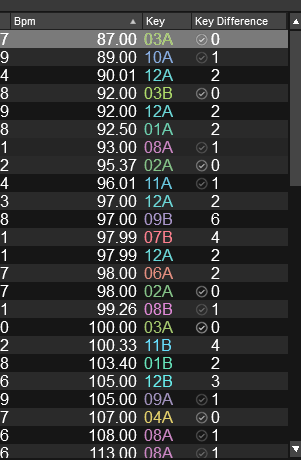

what happened to the Harmonic column in the browser?
Posted Sun 17 Mar 19 @ 3:11 pm
It got better:
Posted Sun 17 Mar 19 @ 3:55 pm
Anyone notice that when actually loading an opposing track and visually see what the “key difference “ changes to in the browser and all that? Especially on tracks that are supposed to be non-harmonically compatible...?
For example it might say 4 under key difference (no check mark obviously) but when you load said track it changes “key difference “ to 0 with now a check mark! On every opposing song loaded!

The check mark takes into account the current "master" deck.
So, any time your master deck changes, the checkmarks change to reflect compatibility with the new master deck.
