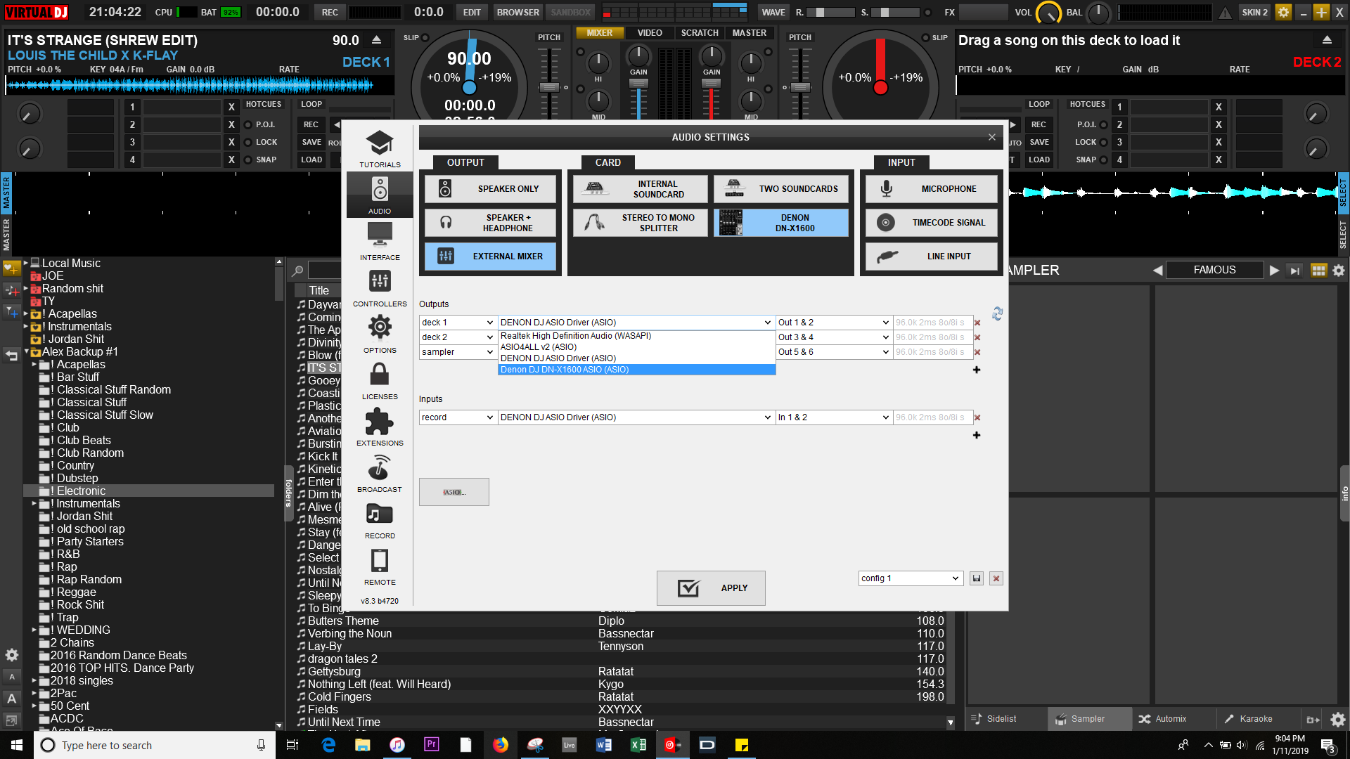

SEE NOW WASAPI DISAPPEARS, WHAT GIVES??? I have changed nothing since using this last night.
VDJ seems very inconsistent (like my hunch about wasapi randomly disappearing earlier in my post). Now, all of a sudden, this random ASIO4ALL v2 appears? Can anyone explain this?
Posted Sat 12 Jan 19 @ 4:09 am
See now the wasapi disappears, what gives??? I have changed nothing since using this last night. The popping is very present now not having the WASAPI option.

ASIO4all is a piece of software you must have installed at some point ... i would remove it in add remove programs.
Posted Sat 12 Jan 19 @ 3:51 pm
Hi wicked, thanks for the reply. Yesterday I realized the asio4all was downloaded onto my computer. Honestly, I must have accidentally downloaded it from the denon website while I was re-downloading the regular denon asio driver.
Anyway, do you have any idea why the WASAPI driver soundcard option is randomly not present anymore? It seemed to not have any popping after 45 mins of play, so I was going to use it again yesterday, but now it's not an available option in the VDJ device settings. Odd?
Posted Sat 12 Jan 19 @ 4:40 pm
