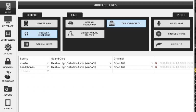

If i have song playing, load track on other drive an audible drop in level is heard, when that track finishes it does it again when i load another track
Posted Sat 28 Nov 15 @ 3:29 pm
What are you're soundcard settings? I think what could be happening is that when you are loading another track onto the spare deck the volume is dropping because it is using one of the channels as a headphone output. Hope this makes sense.

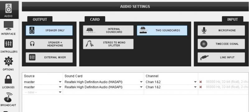

paulpa66 wrote :
This is using on Home PC, will try on main disco PC later tonight
You should either set Headphones as channels 3&4 or you should click on "Speakers" only button.
The way you have set it up, it shows that both Headphones and Master Volume go out from the same channels of your soundcard.
This means a "double" volume when a deck is playing out with PFL selected.
Posted Mon 30 Nov 15 @ 7:15 am
paulpa66 wrote :
Think so as this is fine
Thanks
On this image you should remove the second line completely. So, you should click on "Speakers" only button.
This setup uses the same soundcard channels twice for the exact same reason (send the master volume). Not good! :)
